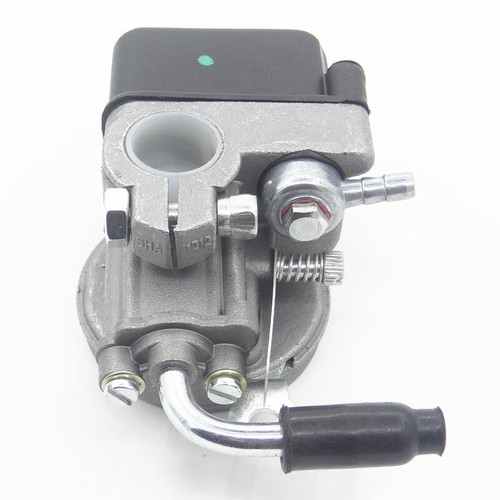

sorry it took me so long to get back to you,. the screw i am referring to is just below the fuel fitting in this picture with the spring on it..... It's really more of an minimum idle adjuster.

Hello, the screw you mean is the idle screw. turn it in to the moment that the throttle goes in movement + a little bit more +/- a third of a turn. The moment the motor runs, change the rpm's by adjusting this screw.....in= more rpm's....

the only problem is that is the only the screw on the carb.
