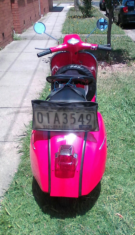

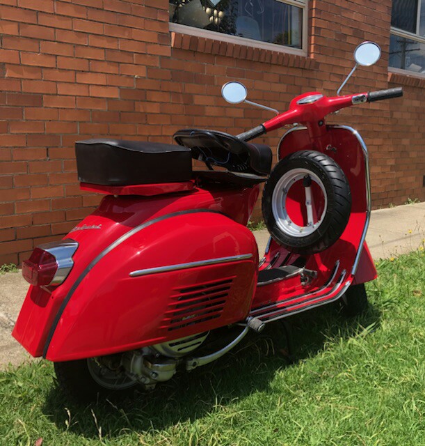

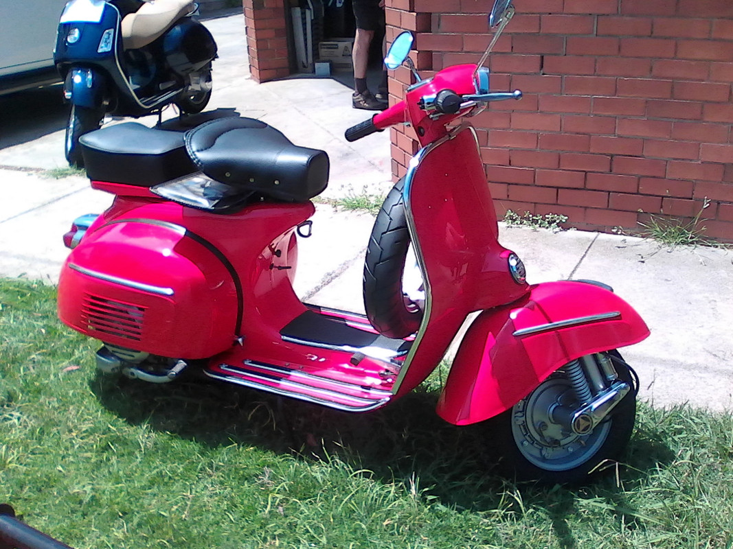

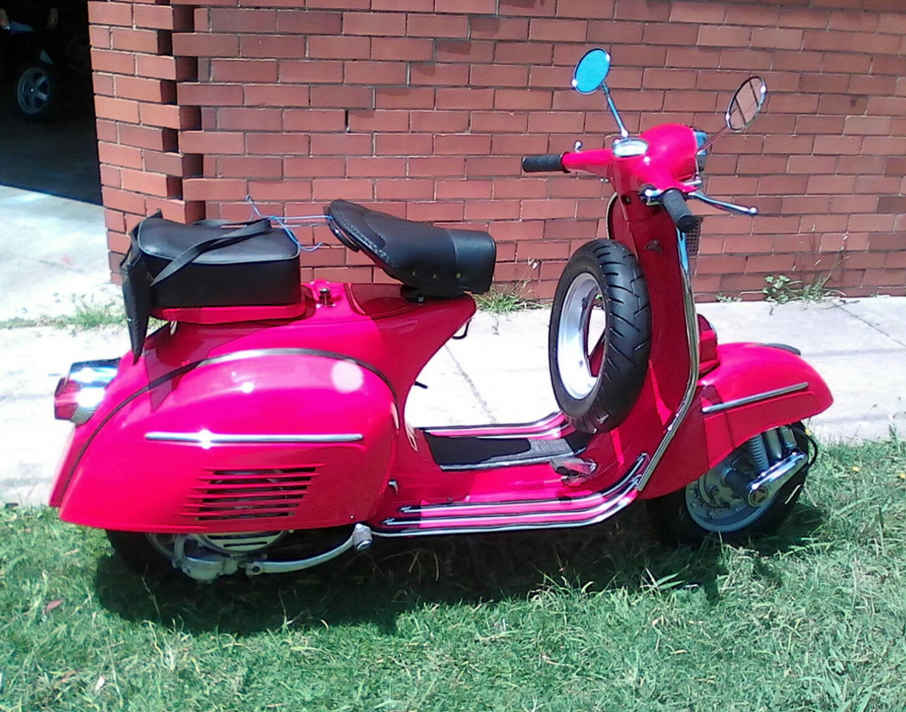

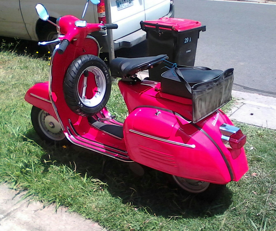

To finalise the epic build story on this 68 Vespa Sprint Roberto (Vespa Wizard) contacted me today and asked if I'd like to drop by his workshop to see the finished scooter. Roberto had recently completed the mechanical and 'bling' refurbishment after picking it up from the painters...who did an amazing job in a 2 pack paint system. The engine has also had a few upgrades increasing capacity to 170cc, suitable larger choke carb, a bigger bore muffler and electronic ignition.
The finished product truly is outstanding especially when you consider the condition of the scooter as first presented!
Here are a few pics of the Vespa. I'm sure Darren (owner) will be truly amazed by the transformation.
The first image shows the correct colour of the Vespa.
