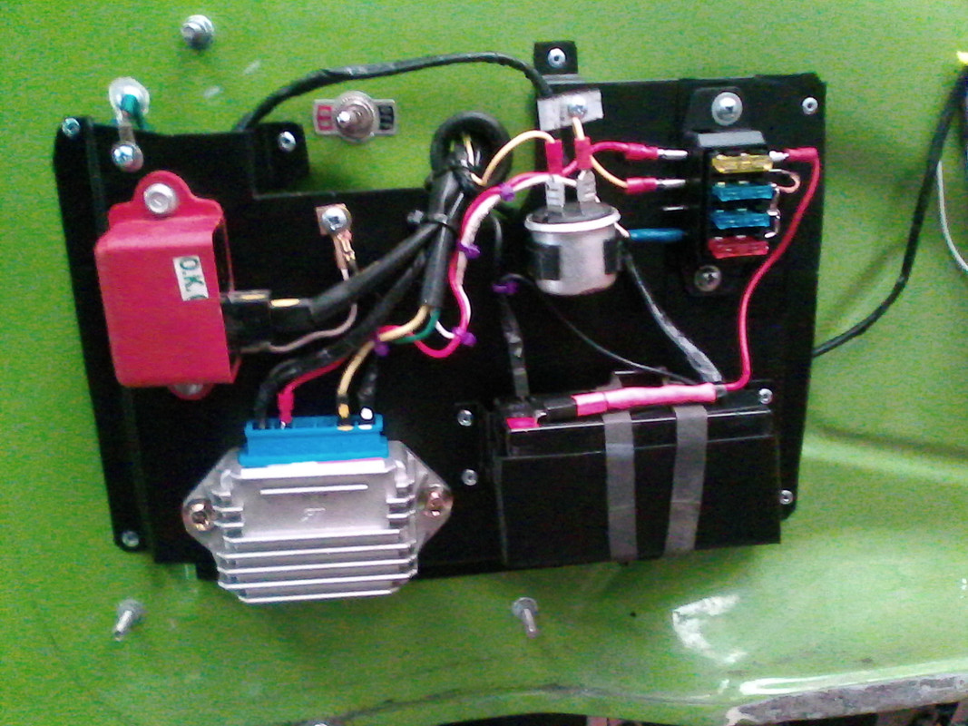

No! The battery charger doesn't know whether the scooter is positive or negative ground/earth. Attach the charger leads to the appropriate terminals on the battery. Red to Positive, Black to Negative.
* Psst! With positive ground you've just got the electrons going in the other direction to the spark plug.
Most cars produced in the UK prior to the 1960s had positive earth/ground charging/electrical systems. Truly no big deal. The only issues are with modern accessories as they are all negative ground.
*If it's running a generator it can be polarized for either negative or positive ground.
*If your scooter runs a coil, the coil works with either polarity or AC
*If it's fired by a magneto...it's AC.
* if someone fitted a battery to the scooter to run an indicator circuit..a module can be fitted/substituted for the original that rectifies the magnetos AC output to DC to maintain a charge in a small 6V rechargeable battery,
http://www.themagnetoguys.co.uk/spark-polarity
